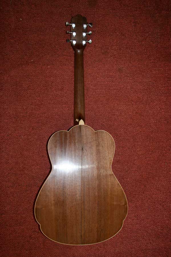

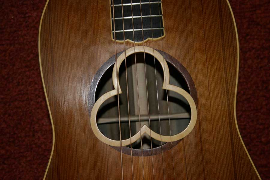

Hello everyone,
I just strung up my first two guitars and I thought I would share some
pictures.

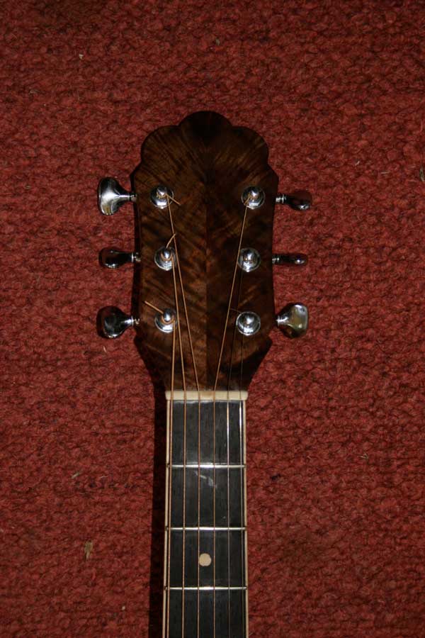

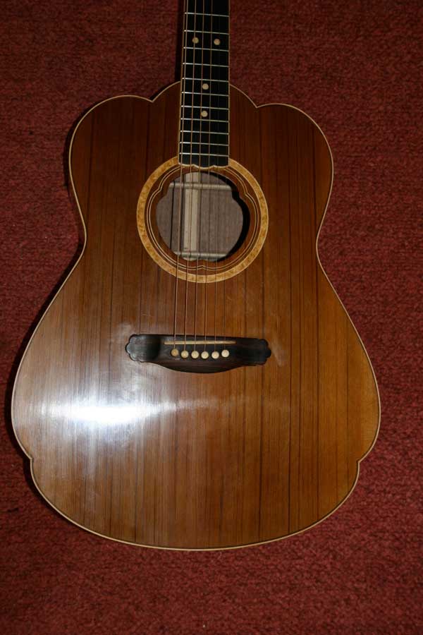

#1: Walnut back sides and neck
cedar top
birch binding rosette and heel cap
rosewood fingerboard and bridge
spruce bracing

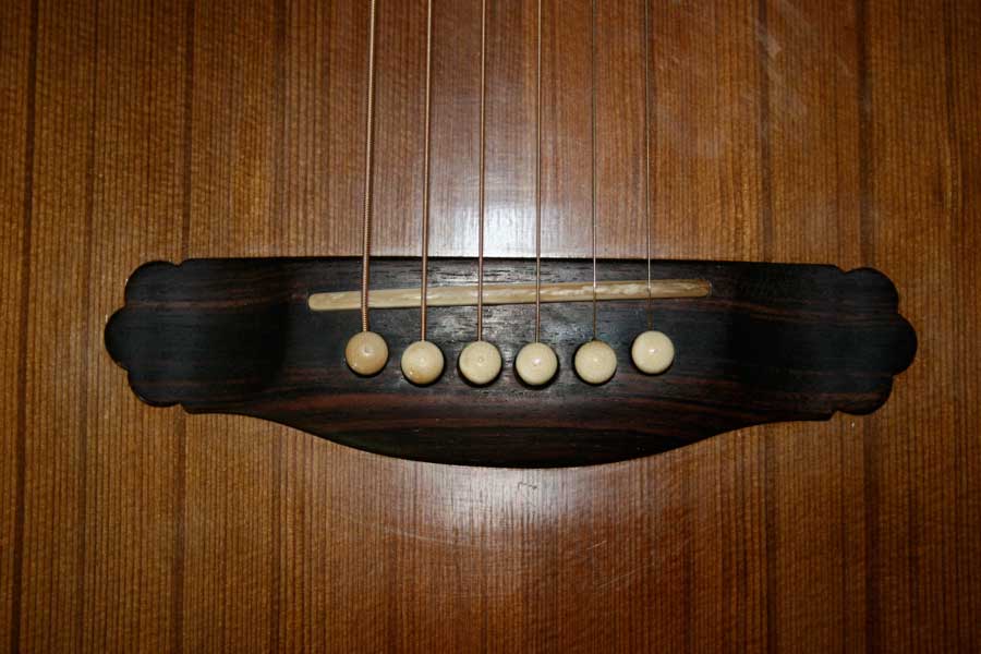

mammoth ivory strap button bridge pins saddle nut and fret markers.
Finish is French Polish, I am going to do a little touch up on the top still.
I am going to make some birch knobs for the tuners and possibly change
to gold.
It has a nice full sound, clear notes good bass and highs, I am really
happy with it.

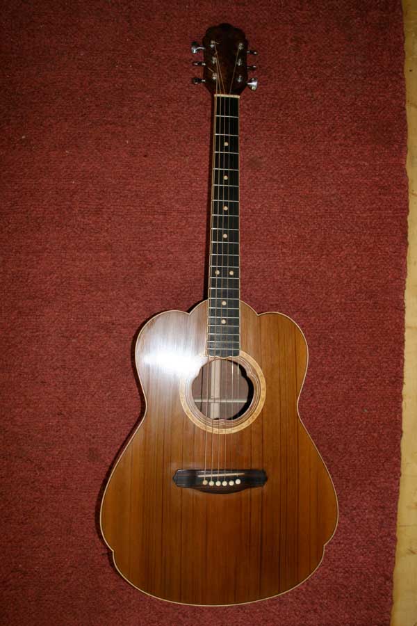

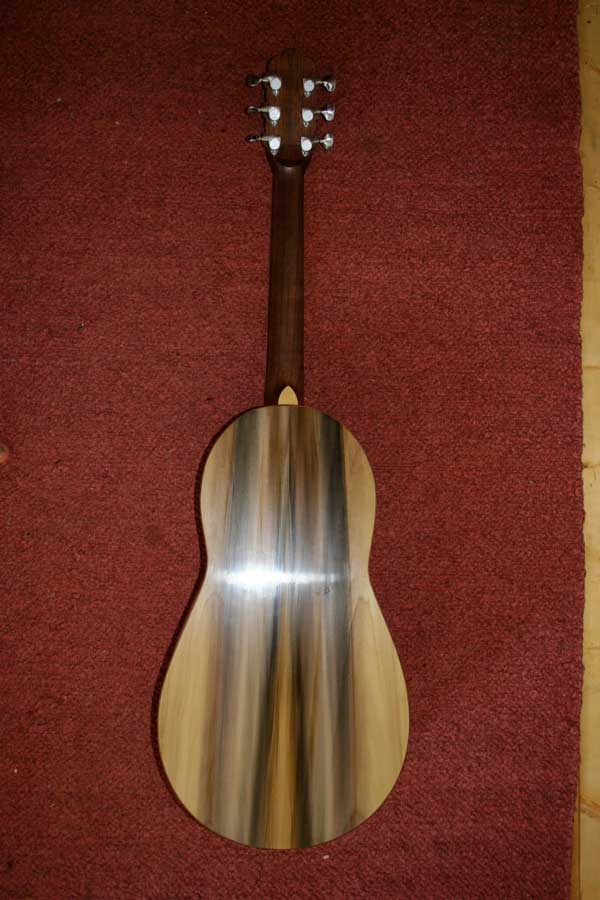

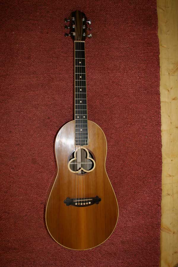

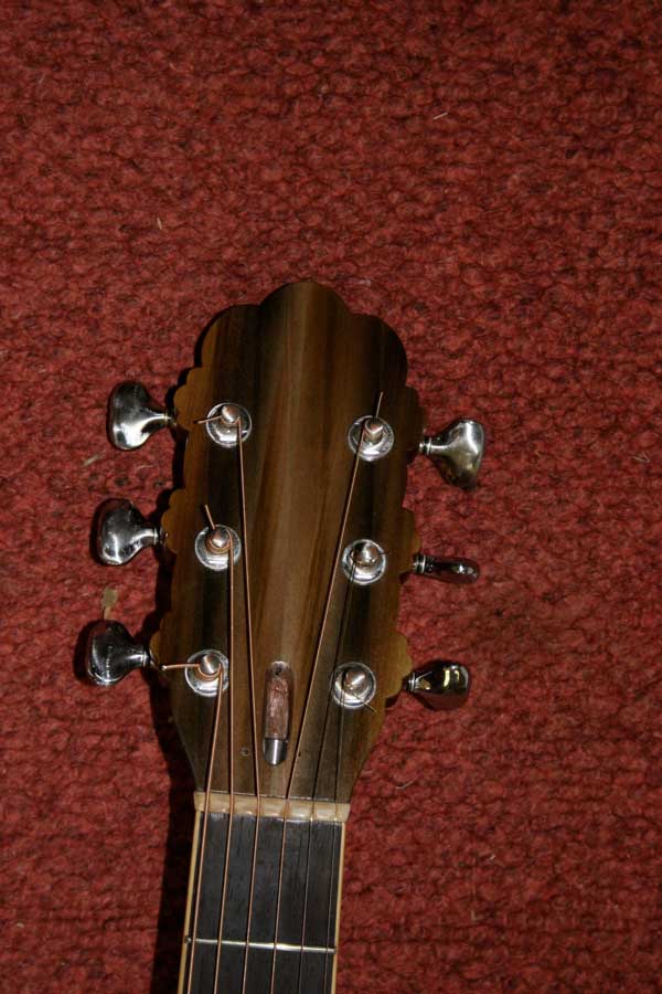

#2
cedar top
tulip poplar back and sides
walnut neck binding and part of rosette
boxwood rosette purfling fingerboard binding
mammoth ivory bridge pins nut saddle fret markers
rosewood bridge and fingerboard
It has a kind of banjo/mountain dulcimer like sound mixed with the
regular
guitar sound (I'm not very good at describing sound).
PostPosted: Sat Jun 16, 2007 5:00 pm
Posts: 1051
Congratulations...both have a very well executed design concept...very distinctive look.
As far as tuners...I like your idea of the birch knobs for the first...while gold will probably look better than the chrome on there now, because both designs have a woodsy theme with use of contrasting woods, birch knobs would look good on both. As far as the shape of the tuning knobs, rather than just copy the shape of the knobs that are there now, it would look very cool if you could repeat the three lobed arc segment design element that you used in both guitars.
Personally I think that while I love the dark look of the woods used for the tops that if you had not added the boxwood contrast it would have been too dark. By playing up the dark and light contrast it rreally helps to balance the design nicely.
The only thing that I would change and it is not at all negative is that in the second guitar the curvature of the tail section of the lower bout makes it so the guitar can not be stood on its tail. Alot of steel string players like that they can stand up their guitar on its tail without it falling over. I really like the proportions of the elongated body but would like to see if fairing out the curve of the tail section would help to even out the continious tight curve of the tail section.
Well done...As you showed in the thread obout how you did the segmented curve section blocking, all of the elements are thought out and stable.
Excellent job and I am glad that the sound is good as well.

PostPosted: Sat Jun 16, 2007 10:50 pm
Very unique and nice. The only concern I would have would be on the first one with the points in the bouts. Those points are natural stress risers and can lead to cracking in the top and back there. Certainly the design is thinking out of the box though, and nice looking.

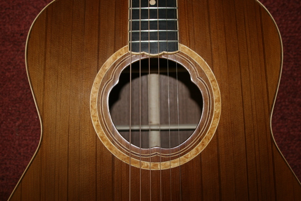

PostPosted: Mon Jun 18, 2007 2:05 am
Those are fantastic! I don't think I have seen anything quite like them, yet they both look natural and harmonious; a well executed design! I would also like to see a closeup of the birch rosette...

PostPosted: Tue Jun 19, 2007 6:43 am
Joined: Sun Apr 29, 2007 9:48 am
Posts: 108
Thanks everyone, and thanks for all your help along the way.
Shawn, I was planning something like what you suggested for the tuner
knobs.
Arnt, here is a closeup of the birch rosette:
Ill try to get some sound clips up before to long.
